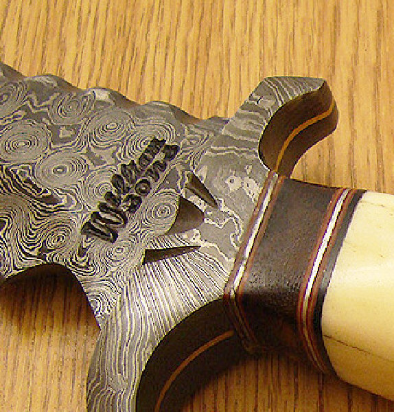

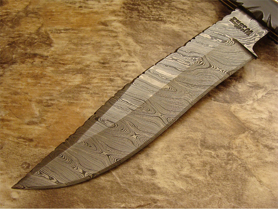

Просто есть ножичек, лезвие 9", толщиной 6.4мм, дамасская сталь.
manah писал(а):Это Damascus pattern, но не Damascus steel...Проще говоря просто узор.
manah писал(а):...производитель?
This is a fantastic bowie with a marvellous unique design, superb unique hand forged damascus blade and a luscious handle of prestigious crown antler and camel bone. This 15.50" massive bowie is not only stunning in appearance but it is also rock solid from tip to but cap and has been purpose built to withstand years and years of use. Wonderful blade is the result of hours and hours of forging. Blade of this knife was hand forged with 1095 and 15N20 high carbon steel true layers (512) in one of the finest twist pattern. Not too many custom makers can keep such layers upon layers flowing all the way to the edge, which actually creates a saw-blade effect at microscopic level, allowing the blade to keep cutting for long period of time, when other blades have dulled.  Rockwell hardness of the blade along its edge is 57 and along the spine is 42-45. Overall length of the bowie is whopping 15.50" and the length of the blade is 9 inches. Extra thick 6.4 mm thick blade has been given excellent heat treatment and was oil quenched. Blade has superb hand grinds on both side, with top side left with a false edge and spine of the blade has a marvellous unique design file work. Rock solid and unique handle of the knife is made of prestigious rare sambar stag antler, camel bone and slices of walnut burl wood with stainless steel, micrata and white fiber spacers. This immaculate knife is complimented with fantastic unique hand made hilt of layers of buffalo's horn, walnut burl and white fiber spacers, fastened with brass pins and strong epoxy for life time durability. Handle is hand sanded, polished and custom shaped which looks and feels great in palm. The weight and balance of the knife is excellent and provides an excellent grip and hold. This unique knife with a 1-of-a-kind handle feels great in hand.
